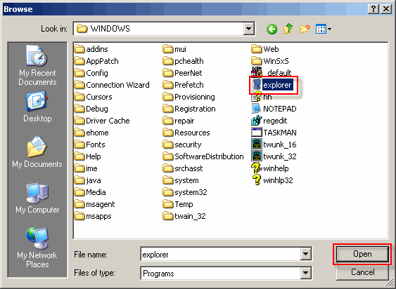

    InformationOn the below picture as an example you can see file C:\Windows\explorer.com
    # minimize main program window
    # open up Task Manager again (press simultaneously Ctrl, Shift and Esc)
    # in Task Manager go to menu FIle
    # click on New Task (Run)
    # click on Browse
    # select folder C:\Windows
    # select file explorer.exe
    click OK two times
